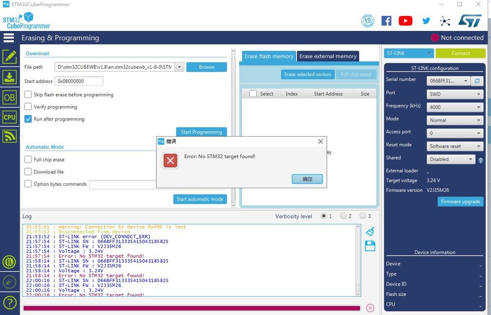

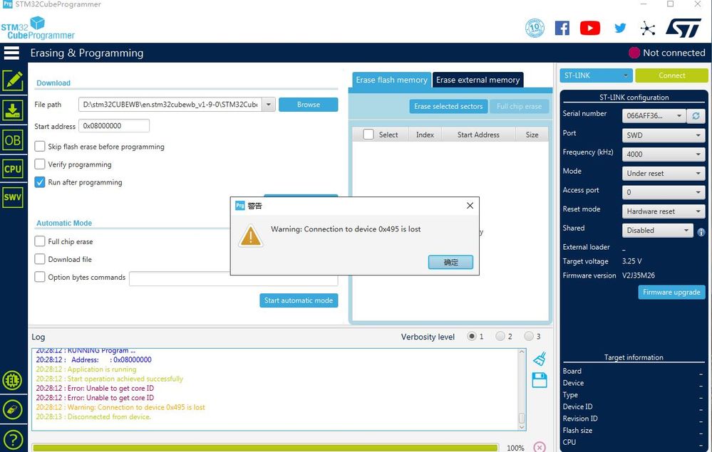

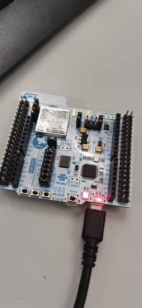

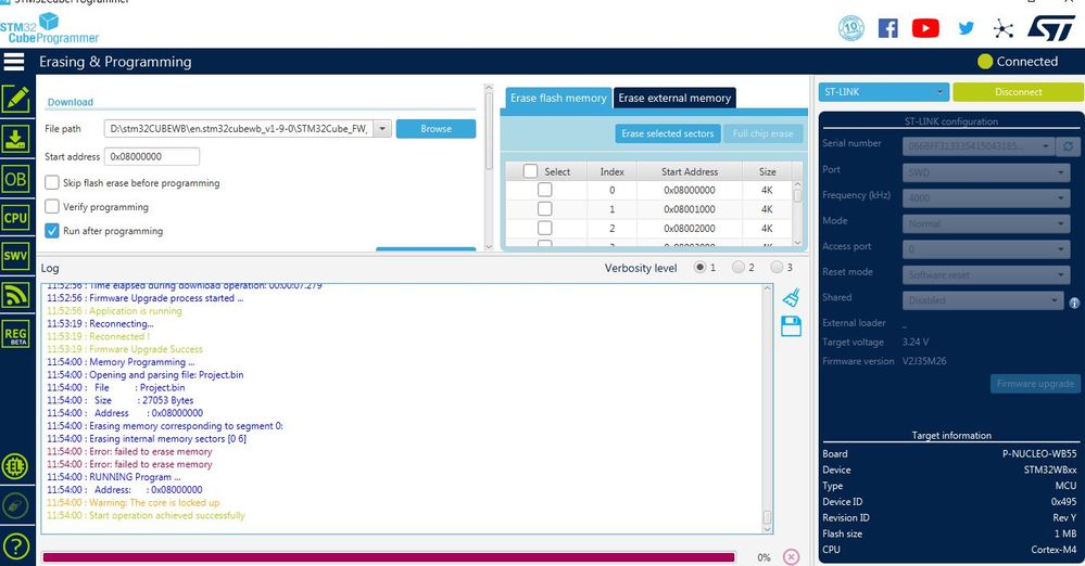

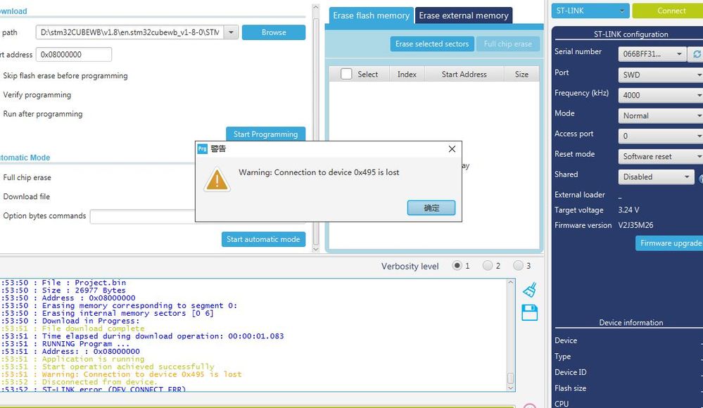

I am using the official engineering code Thread_SED_Coap_FreeRTOS. When downloading with STM32CubeProgrammer, the error message connection to device0x495 is lost appears. At this time, the program should fail to download because the LED1, LED2, and LED3 on the board are not lit, so I want to use it again When downloading programs on this board, STM32CubeProgrammer reported an error ERROR:NO STM32 TARGET FOUND. What is causing this? I downloaded other project codes normally.THANK YOU

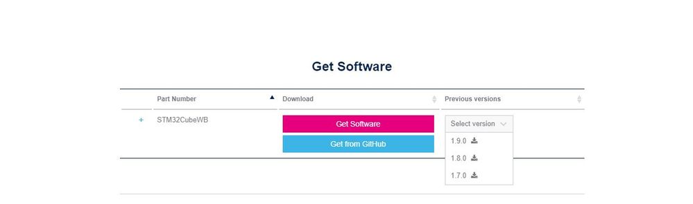

Hello, thank you very much for your answer. I am sure that I have upgraded the STM32 CubeProgrammer to the latest version, and I am using the version V1.9.0, but the problem still exists.I only found 1.9.0 STM32CubeWB on the official website.Hope to have a solution soon, thank you

Hi @ZB.1
Can you please try to connect with "Under Reset " Mode instead of "Normal" mode?
Houda
2021-01-05 4:35 AM
Thank you very much for your answer. Under your suggestion, I tried again, but the problem was still not solved, and I didn’t see the effect that this project should have.
