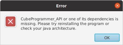

So, I tried executing the commands in the manual.
However, the result is as follows:
I am using Ubuntu 20.04 and I have read that a lot of people are having the same problem as I am.

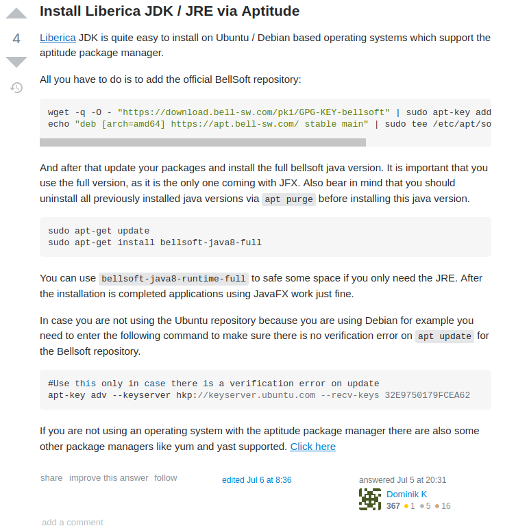

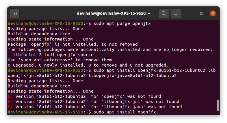

I tried these steps that I found on stackoverflow
However when I try to reinstall the program and run it, it still shows the same message.

HI @devinahw ,
If you are using STM32CubeProgrammer v2.6.0 , no need to install java, the JRE is embedded inside (OpenJDK JRE).
Please use STM32CubeProgrammer icon created in Desktop for launching the tool (the Icon may need to be enabled manually in Ubuntu 20 -> right click on the icon and allow it).
