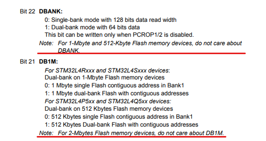

Question 1: What is the difference between the user configuration option bits DB1M and DBANK?
According to the STM32L4 reference manual:
DB1M:
DBANK:
Based on the descriptions in the reference manual and STM32CubeProgrammer, they do the same thing. Having two bits with the same functionality seems unlikely, so there must be a difference.

I reached out to a FAE directly since I didn't get a response on here. Turns out that older versions of the STM32L4R9 reference manual (RM0432) are missing the following key notes:
In summary, use DBANK to toggle dual-bank mode when using a 2 MB flash device. Use DB1M to toggle dual-bank mode when using a 1 MB flash device. As for why there isn't just one bit for all devices regardless of flash size, that remains a mystery.
