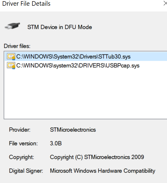

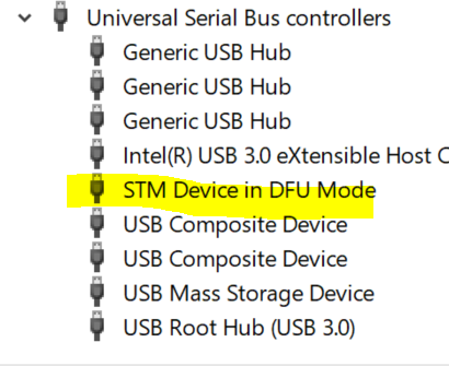

PROBLEM FOUND: (Win10 STM32CubeProg USB Drivers)
Changing the "STM BOOTLOADER" Device driver using Device Manager to the DfuSe USB Driver found in C:\Program Files (x86)\STMicroelectronics\Software\DfuSe v3.0.6\Bin\Driver\Win10 cause the STM32 device to enumerate as "STM Device in DFU Mode", which allowed DfuSe to find the STM32 device and allowed me to flash the Micropython DFU image.

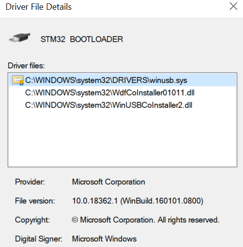

Here is the the Device Manager information for both PCs. PC#1 cannot find a DFU Device with DfuSe, PC#2 can find and program a DFU Device with DfuSe. I am trying to determine why PC#1 does not enumerate the USB device as a DFU Device. Configuration: Both usb connectors from the target (stm32f4 disco) plug into a USB hub. To test between PCs I move the main USB hub cable between PCs, which preserves the target hardware configuration between tests. I am trying to determine why there is a driver difference and how to fix the PC#1 drivers such that I can see the disco board as a DFU Device.
In answer to your question above, on the bench I use a jlink ultra, however, I am pursuing the use of DfuSe in hopes for easier field upgrades, where only a USB connection is required/available.
Device Manager PC #1: (DfuSe does not find a DFu Device)
Device Manager PC#2: (DfuSe works)

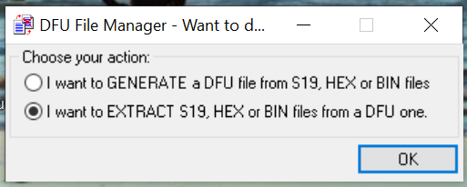

Might be time for a new thread on this topic because there is probably interest in continuing to use DFU files on systems where is is desire to have both DfuSe and STMCubeProg both installed.... However, here is the process that worked for me with a DFU file (not Micropython specifically). I used the DFU File Manager app (packaged with the DfuSe download from ST) and chose to Extract DFU file to HEX. I then uploaded the HEX file with the STMCubeProg (v.2.6). Please try this process with the Micropython DFU and let us know if it works for you.
