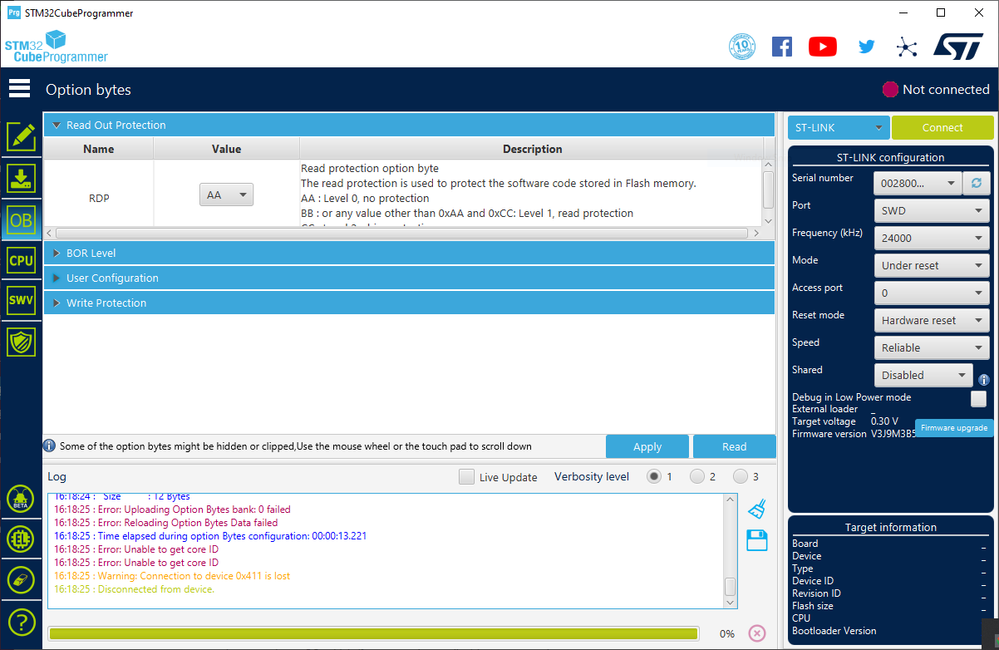

NVIC_SystemReset( );I have no idea where he got the value "55" but the upshot is I can't reset my OBs. When I try, I get this output from the programmer software:
15:15:33 : Option byte command : -ob RDP=170
15:15:33 : PROGRAMMING OPTION BYTES AREA ...
15:15:33 : Bank : 0x00
15:15:33 : Address : 0x40023c14
15:15:33 : Size : 12 Bytes
15:15:52 : UPLOADING OPTION BYTES DATA ...
15:15:52 : Bank : 0x00
15:15:52 : Address : 0x40023c14
15:15:52 : Size : 12 Bytes
15:15:52 : Error: Uploading Option Bytes bank: 0 failed
15:15:52 : Error: Reloading Option Bytes Data failed
15:15:52 : Time elapsed during option Bytes configuration: 00:00:18.761
15:15:52 : Error: Unable to get core ID
15:15:52 : Warning: Connection to device 0x411 is lost
15:15:52 : Disconnected from device.So, my questions are:

Hi Pirahna - thanks for the reply. What's wasn't clear to me is whether a value of 55 might have been interpreted as a CC, which (from my understanding) is a one way trip. I guess the passage from the reference manual you cited suggests not.
These are the settings I've used...thanks.
