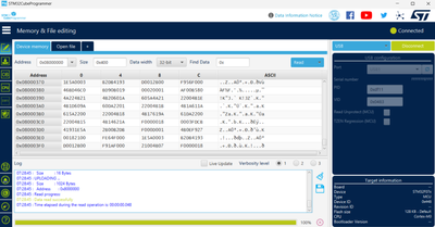

Interestingly, using the DFU-util v0.8 program I can connect to the MCU and successfully read/write memory:
