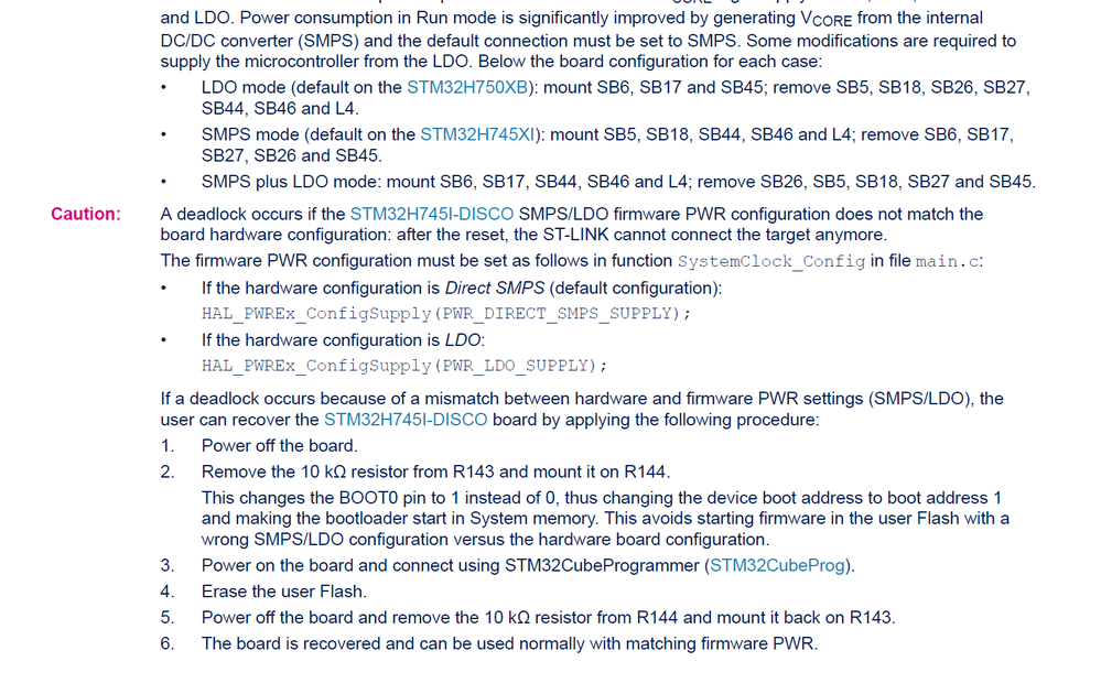

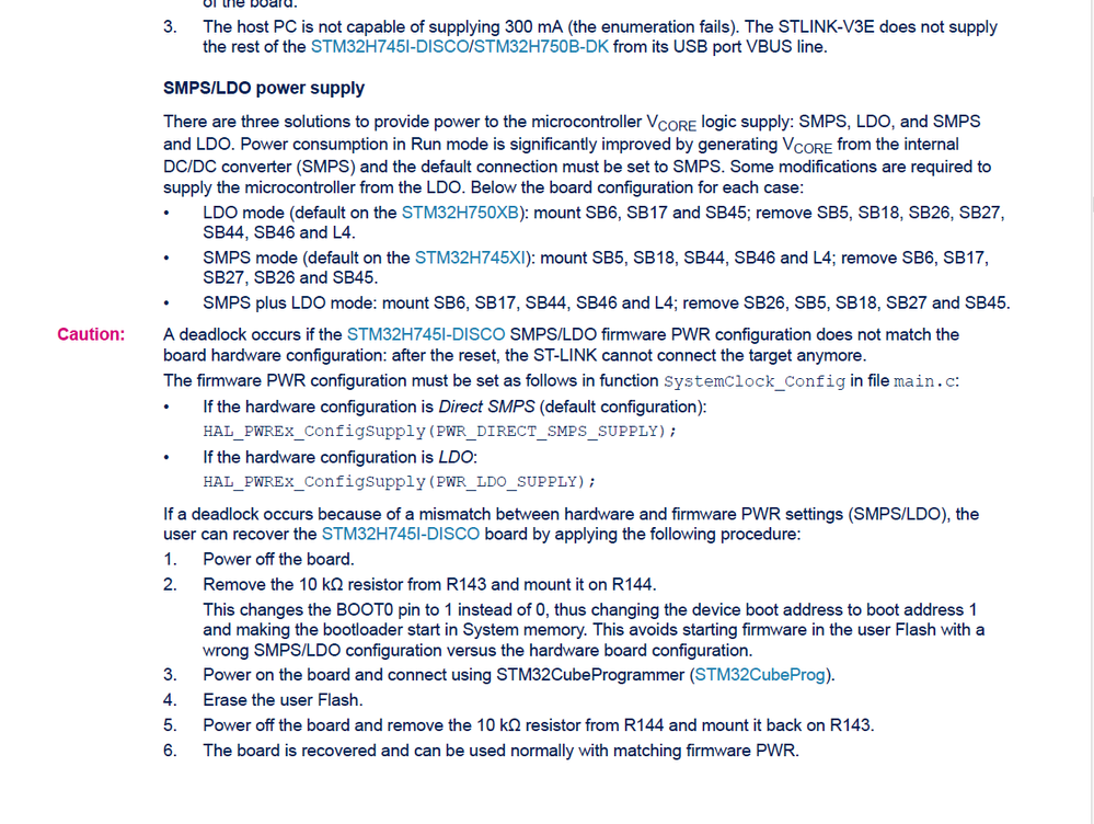

2020-10-15 4:04 AM
Hi ,
Yes the STM32H7 was Bricked , I am able to now recover the board 10K resistance De-Soldered from R143 and Soldered on to R144 .( There should have been an Jumper provided or ,, the ST-LINK should have had GPIO method to recovered the board )
After Going through the user manual it is mentioned in an Caution: :sad_but_relieved_face:
