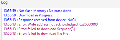

I currently program a STM32F303 with the app STMFlashLoader Demo, using a USB-RS232 device. I want to replace that app with CubeProgrammer, but the app is sending an error. I already checked my FW, but it is OK.
So, I want to know if you can help me to fix this error without affecting the programming of the device.

0x20000000 is RAM
Build your project for 0x08000000 that's where the FLASH is situated
The object file shouldn't be describing RAM, it's the responsibility of the startup code to initialize/copy initial content in RAM
