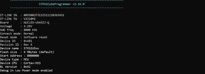

I've tested using the NUCLEO-U5AZJ-Q:

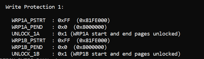

The default value of the WRP1A_PSTRT and WRP1A_PEND are 0xFF and 0x0:

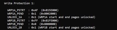

Then, using the command " STM32_Programmer_CLI -c port=SWD mode=UR --hardRst -ob WRP1A_PSTRT=0xaf WRP1A_PEND=1 ",I've been able to set the WRP1A_PSTRT and the WRP1A_PEND to 0xAF and 0x1:

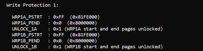

and Finally I've executed the command " STM32_Programmer_CLI -c port=SWD mode=UR --hardRst -ob WRP1A_PSTRT=0xff WRP1A_PEND=0 " which take back the WRP1A_PSTRT and the WRP1A_PEND to 0xFF and 0x0:
