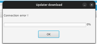

Upon launching STM32 CubeProgrammer today, I encountered this dialog:
In case the image doesn't show, the text reads:
The server connection is not established.
The network connection is required to download updates.
Please check your Proxy Settings.
This thread refers to the same error and is marked "Solved" but the solved problem is actually a different error, described in the same thread.
This message does not interfere with programming, but I'd sure like it to go away.

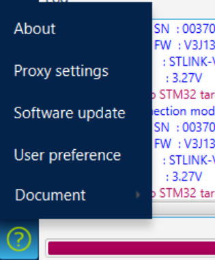

Hello @Brian H
Have you tried checking the "Do not show this message again checkbox" in order to not see the message again ? If you would like to update CubeProgrammer, you have to configure your proxy settings through "help->proxy settings".

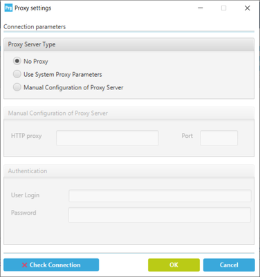

Hello @Brian H
In that case, I think we should get more details from you (I tried reproducing the issue on my side using CubeProgrammer v2.15 & v2.16, the pop-up doesn't appear even if proxy settings are not configured properly).
Could you share :
- The CubeProgrammer version you're using (If it's 32 bit CubeProgrammer please specify)
- If you're using 32-bit or 64-bit Windows.
- A screenshot after you click on "Help->Proxy settings->Check connection".
Thanks in advance,
Aziz
2024-04-25 7:32 AM
From Help->About:
STM32CubeProgrammer v2.11.0
After clicking Check Connection:
(Nothing about the window changes; the X was already present in the Check Connection button and remains present).
I wonder if this older version is trying to contact a URL that is no longer valid?
