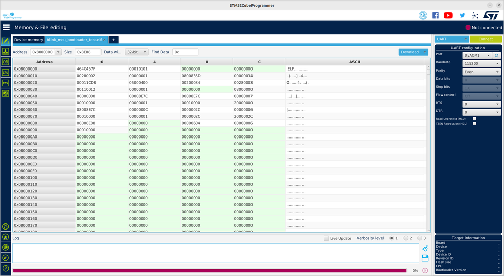

If I view the ELF file for a simple blink program on STM32CubeProgrammer looks like this

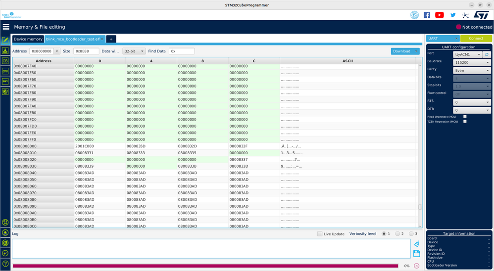

It starts something at 0x08000000 If I scroll down to address 0x08008000 it is like this
For Erase & Programming, it starts writing firmware from address 0x08000000 and not from 0x08008000.

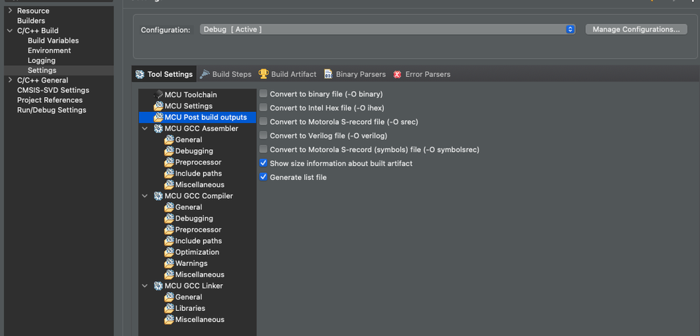

If you need to change the start address you need to compile your firmware as a .bin file. It's not working with an .elf file. You can change this in the project properties. Please check "Convert to binary file".
