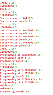

The following image is a log generated by the external loader. The lines "0x3401<LF>" and "0xb510<LF>" is the data I was checking to see if there's corruption or not. The correct lines should be "0x0<LF>"

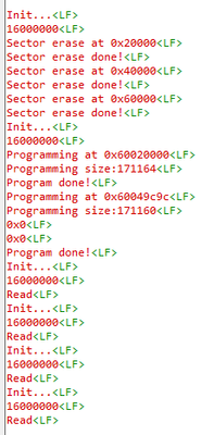

Another strange thing is if I use the external loader with the old tool StLink Utility also there's no corruption. The only thing I can see is there is only one call of Write function instead of 2 times in CubeProgrammer. The following image is the log generated by external loader when StLink Utility is used

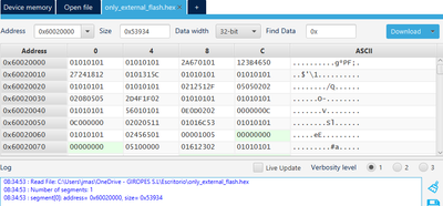

I've made a linear binary starting from 0x60020000 and 342324 bytes to program.

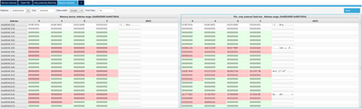

But if I do a comparison between memory and file there's a lot of regions with a wrong data. The first wrong occurrence was in the address 0x6004C580 but it changed every time I tried to program. Anyway always was when Write function was called in the second time.
