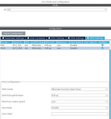

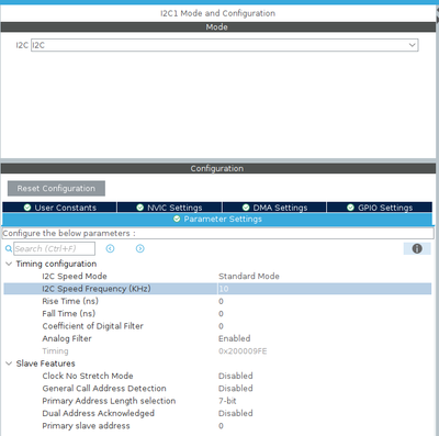

2024-07-14 10:38 PM - edited 2024-07-14 10:40 PM
Set pullups in Cube ...see:
for all used I2C pins ; no pullups = no I2C game.
set speed to something low, 10 kHz or so;
2024-07-14 10:50 PM
my bad!!!!
i thought when i click on the gpio pins their setting would pop up,
but i have to scroll!!!
thanks a lot.
