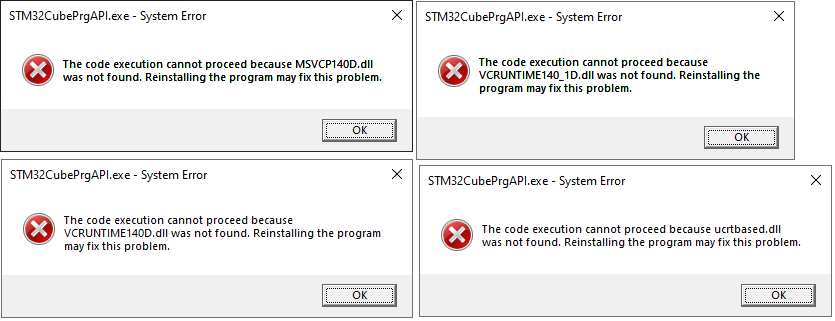

I'm using the C++ api on 64 bit machine with success. When run the exe on another PC some DLL's are missing. It seems some of them are 32 bit. Can you please tell which version these DLL's requires - the 32 or 64 bit?

Possibly need the MSVC Redistributable files from the version you used. You'll need the 32-bit ones if the app/library are 32-bit.
Use PEDUMP or other tools to check what import expectations the DLL has.

Thanks for the fast answer.
I found it. The application is 64 bit but needs the 32 bit version of these DLL files.
