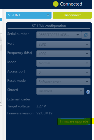

2020-11-03 2:02 AM
I use latest firmware.

2020-11-03 2:06 AM
Could you please specify the board name.
