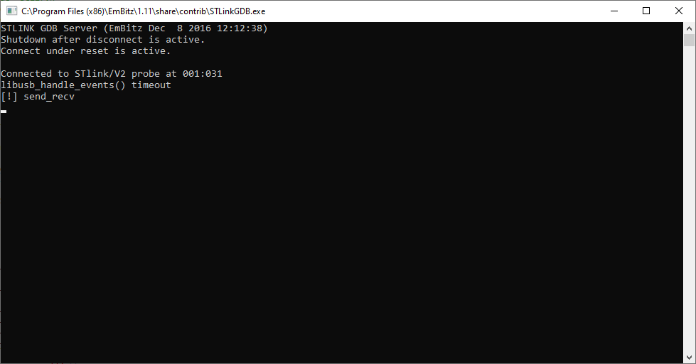

I migrated to L4Q5 MCU and the Embitz debugger is not able to see the Target. I have pointed the build options to the new linker file. However, I feel like I need to translate STM32CubeProgrammer settings to the Embitz debugger options. What do I need to do to make it work?

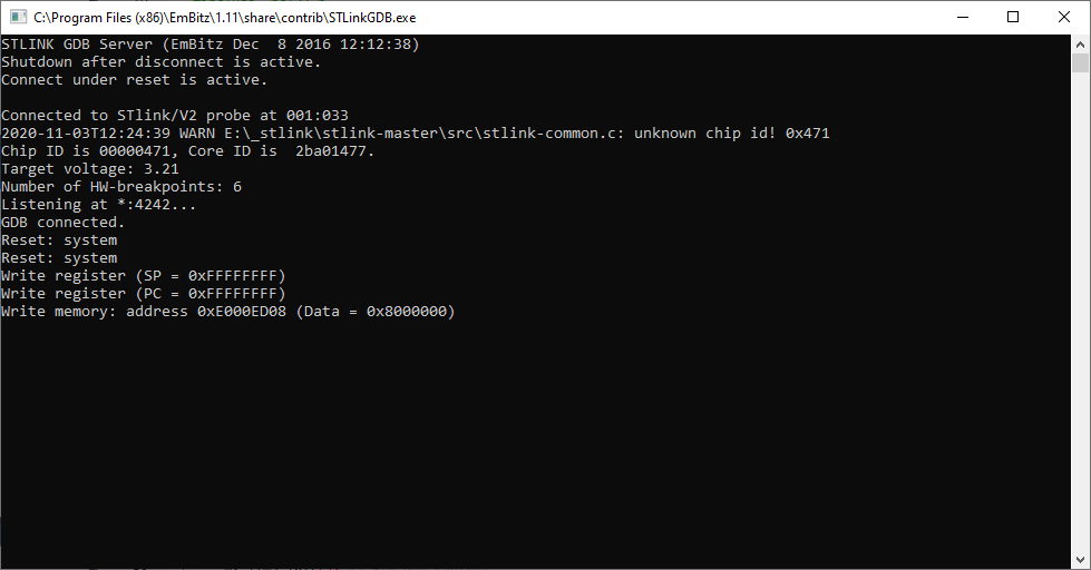

I have made some progress by finding the right .svd file. However, I still have some problems with the debugger. It seems that the chip ID is unknown somewhere?

The assert provides the source file and line for the test. Modify and recompile the indicated file, or find updated file with fix.

I cannot find stlink-common.c ...? I do not have an E: drive...
Where would that be?
2020-11-03 12:42 PM
Not your hard drive
https://github.com/stlink-org/stlink/blob/develop/src/common.c#L1327
Perhaps find yourself a copy of the STLINK GDB Server that isn't 4 YEARS OLD!
