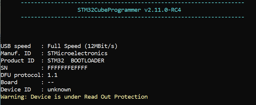

we're having some issues while trying to connect a STM32F030C6 to the Stm32CubeProgrammer via USB, through the embedded STM32 Bootloader.
Using the same working sample of one of our devices, we perform several connection tests on different Windows 10 PCs, all set up with the following configuration:
All the PCs were able to properly detect the device in bootloader mode, showing "STM32 BOOTLOADER" in "Device Manager" and some of them were able to properly connect to the device, allowing us to perform DFU operations.

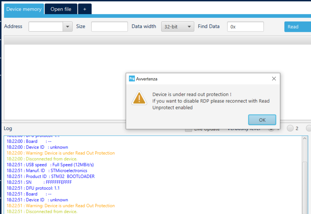

However, on some PCs, the following warning appeared, and no matter what we tried (flag set on "read unprotected", power cycles..etc), we weren't able to connect to the device:
Strange thing is, on those problematic PCs, if, instead of using the embedded laptop USB port, we connected the device through an external USB HUB, we were able to connect properly.
This issue is causing us some troubles because some of our customers are stuck and cannot perform the FW update of our devices on the field, and tell them "try to use an USB HUB" is a not viable option.
The issue is sistematic and not related to a specific unit of our device, those problematic PCs always failed, even trying with different units.
The root cause could be in the HW/FW design of our devices, or in the STM32CubeProgrammer toolchain, so:
Can you please help? thanks!

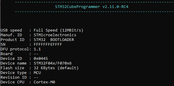

Hi and thank you for your prompt support, unfortunately it did not work, here is the result:I tested the SAME DEVICE on my PC and it gets recognized correctly:

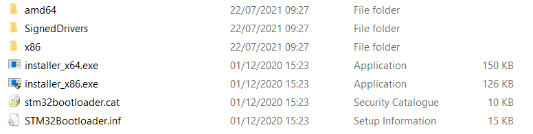

to perform DFU operations with a custom C# application that we wrote and we're getting the SAME error of the STM32CubeProgrammer. The only thing common to both program is the DFU_Driver (which we install upon the installation of our C# applicataion by calling "STM32Bootloader.bat" inside the path: STM32CubeProgrammer\Drivers\DFU_Driver)
