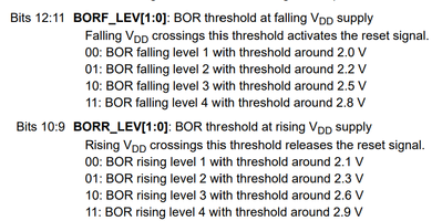

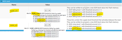

Register name and description don't match (rising register, but falling description, and vice versa).
Which one is correct?
2024-02-13 7:37 PM
Rising voltage is higher than falling voltage. Description on the left is correct.
The reference manual is the best reference source.
See this post, STM32CubeProgrammer might be writing them to the wrong locations anyway. Unclear.
2024-02-13 7:37 PM
2024-02-13 10:22 PM
Thanks for the answer & the link to old issue.
At least for now the address location is correct for -ob BOR_EN=0x1 BORF_LEV=0x3 BORR_LEV=0x0
Only descriptions inside GUI need to be swapped.

Hello @FArdi.1,
Thank you for bringing this issue to our attention.
I reported internally.
Internal ticket number: 205883 (This is an internal tracking number and is not accessible or usable by customers).
Thank you.
Kaouthar
2025-07-09 5:37 AM
Hello @FArdi.1 ;
The issue is fixed in STM32CubeProgrammer 2.20.0 version.
