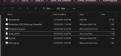

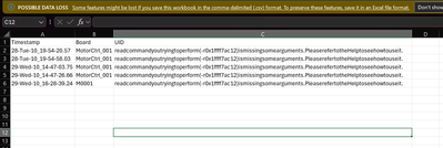

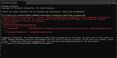

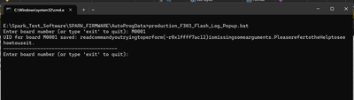

2025-10-29 4:02 AM - edited 2025-10-29 4:08 AM
Hell @Bob S ,
Pls. find attached one Bat File FYR.
You can suggest related document / post already available to understand it.
1. Following is , When I run it with Windows PowerShell
2. When I run in CommandLine
3. CSV LogFile
4. Folder view on my PC , all file in same Folder
2025-10-29 10:05 AM
And what does that error message lead you to? I'm guessing the batch file turns off echo. If so, enable it so you can see all the lines that execute.

That is not the same file that generated the error messages in the 2nd image you posted. In the image, the prompt is "Enter board number", but in the file you posted it is "Enter board ID". The file you posted also has echo lines that do not appear in the image. And other differences.

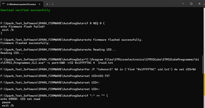

Hello Bob,
Since you mentioned "Automate production programming through batch file you do all the time" , we were expecting some ready to go script / pointers if you can list out.
Considering your suggeston for breaking down code path , i have removed the Wrapper and just rewrite Short batch file step by step.
See the New Batch file as Below , Firmware Download Works and RDP1 set works fine. But, UID Read/Write Fails
