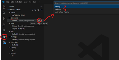

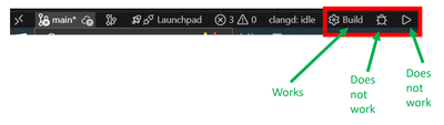

After trying that I went back to the debug preset and out of the three buttons on the bottom bar (build, debug and run - see screenshot below) only the build works. The debug button and run button don't. But the main menu's F5 ("Start Debugging" and CTRL+F5 ("Run without debugging") do work correctly.
When I press the bar's debug button it gives this error:

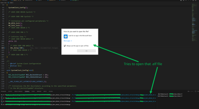

And when I press the bar's run button it tried to open the .elf file which does exist and the location is correct. But not sure what is trying to open it and most importantly why...

Looking at notification details source is CMake Tools extension. Nothing STM32Cube may do / being involved here i guess.
