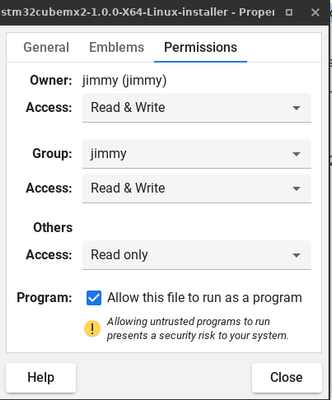

I tried to install the STM32CubeMX2 on Linux Lite 6.6 which is base on Ubuntu 22.04, but get unsupport file error.
I double check that I allow this file to run as a program.
