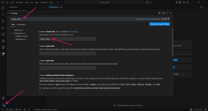

2026-03-27 9:59 AM
Hi @Karl Yamashita
Yes, for the Cube bundle, all bundles are now up to date.
What you need to do is check the CMake path in the VS Code settings and set it to "cube-cmake" as shown:
2026-03-27 1:47 PM
I checked the path and it was set for "cmake" instead of "cube-cmake", so updated it.
