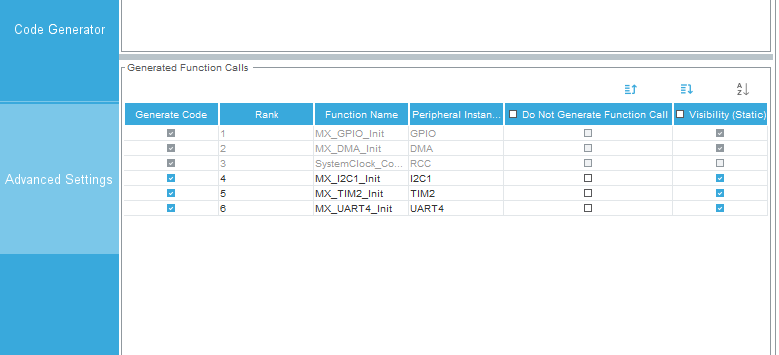

Meanwhile, you can make sure that the initialization functions are correctly ordered through Project Manager view > Advanced Settings tab:
Hope this clarifies the situation.
