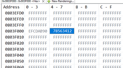

My code is
uint64_t data=0x1234567890ABCDEF;
HAL_FLASH_Unlock();
HAL_FLASH_Program(FLASH_TYPEPROGRAM_DOUBLEWORD,0x0803F000,data);
HAL_FLASH_Lock();
The data have been stored in the desired address. My doubt is, as per the manual I didn't set PG bit and check any status of the flash register but I got an output how?
