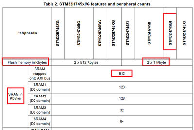

The STM32H745BI has 2MBytes of internal flash so you have enough to put a full framebuffer in it, maybe enough for a double depending on your display resolution and color precision:
