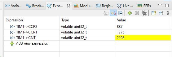

The TIM register counts up correctly. No problem in counting. but no change in CCR1 and CCR2 register occurs.

I've used HaL code and the STM32cubeMX generated code. I have no idea about the registers.

What @Community member ment: There is a SFRs tab in your above screenshot. This shows the registers in a tree view.
