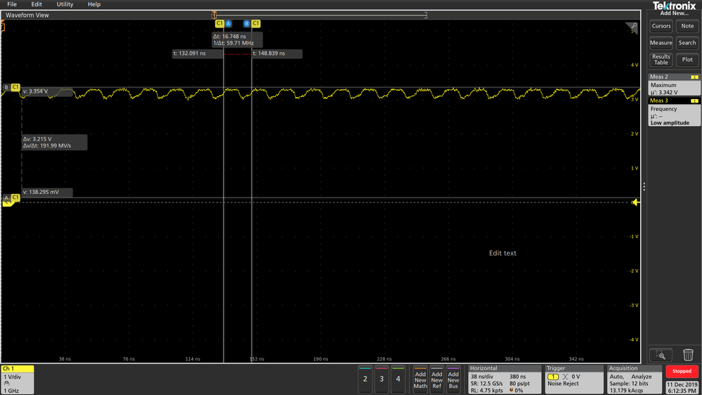

2019-12-12 1:09 AM
we measured the LSE clock in PA8 port using MCO1. We did not get the expected clock .
Attached the waveform we got.

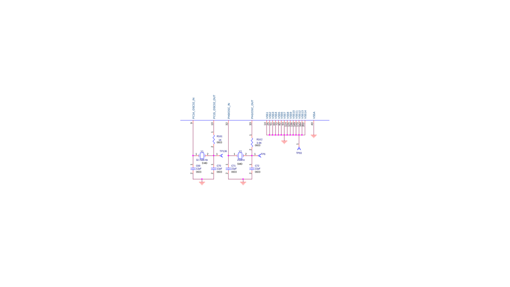

We have calculated and used load capacitors as per STM32 crystal guidelines. We assumed stray capacitance to be 0.5.
Attached the crystal circuit.
