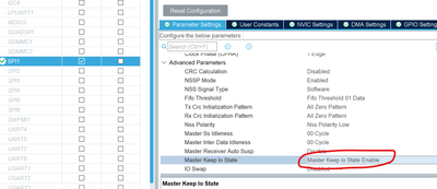

When the peripheral is disabled, the pin will float unless you set it to keep the IO state here:
