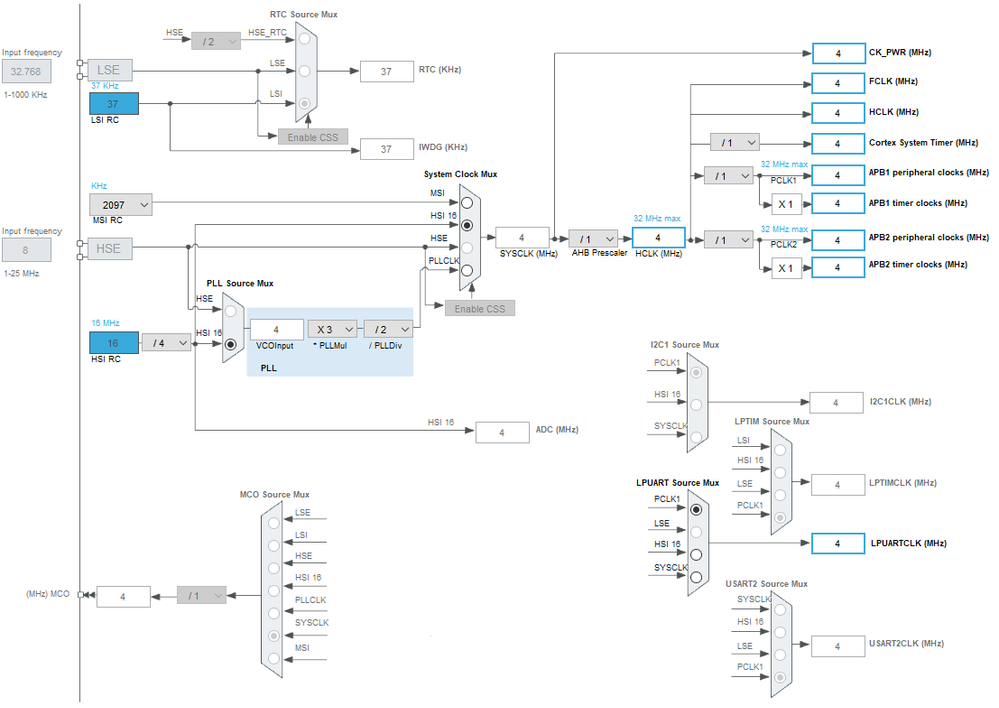

I'm trying to setup a project with STM32CubeIDE 1.8 (includes CubeMX 6.4) that uses LPUART1 on a STM32L031K6. I want to lower the CPU frequency to 4MHz, and, to reduce power, I'm using HSI/4 as clock input.
0693W00000JO5yjQAD.pngLPUART baudrate is set wrong (4 times higher than expected according to logic analyzer), it's generated out of PCLK1 frequency that is assigned as HSI_VALUE >> 2. While HSI_VALUE is defined in stm32l0xx_ll_rcc.h:

Hi @Pavel A.
When I create a new project with HSE/4, there is no definition of HSI_VALUE in the project properties as long as I generate with the HAL drivers. After a switch to LL drivers in CubeMX and a generation, the .mxproject AND the project properties show DEFINES for all the clock sources, including HSI.
