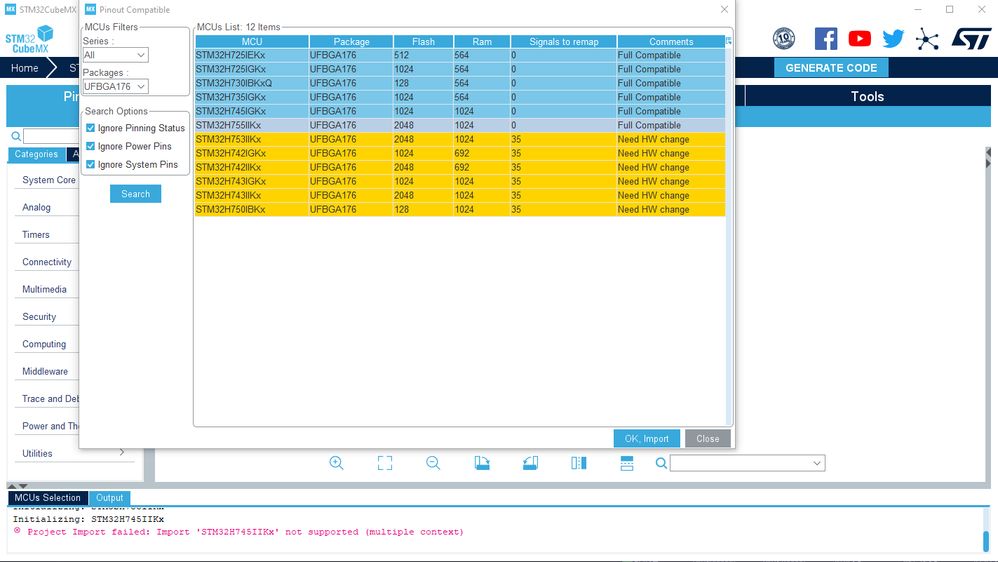

I'm having trouble porting the existing CubeMX configuration to a pinout compatible MCU.
I'm using STM32H745IIK6 and trying to change it to STM32H755IIK6 following the instructions on page 287. of UM1718 Rev 34 ("Tutorial 5: Exporting current project configuration to a compatible MCU"). But, when I select the MCU and click "OK, Import", I get the following error:
The existing CubeMX configuration loads fine and I can modify and save things, but when I try to do this MCU change, that error occurs.
Is there any fix to this, since it would be pretty annoying to have to manually copy everyting from the existing CubeMX configuration?
I'm using version 6.2.1.
BR,
Domagoj
2021-06-16 7:16 AM
Hello @Domagoj Tomić ,
You're right, I can reproduce the issue and it will be fixed.
Thanks for raising the problem to our attention.
Khouloud

2021-06-16 3:18 AM
2021-06-16 7:16 AM
Khouloud

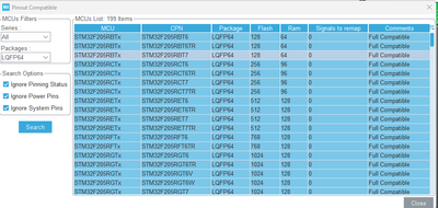

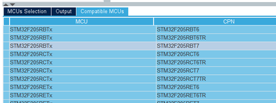

2023-09-20 6:16 AM
I am running into a similar issue with 6.9.2:
In my case, the button is simply gone to "import"
I do get an extra coloum at the bottom IF I move the bar widths (otherwise it doesnt even show), but I cannot migrate my project to another mcu..
