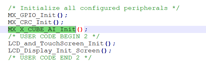

I've successfully generated a project with X-CUBE-AI. I searched for some examples on the internet and I've found that MX_X_CUBE_AI_Init is missing from my project. Why this function call is missing? I've the latest CubeMX.
2023-08-13 4:43 PM
Is the function created? Share your IOC, probably an unchecked box in the initialization settings.
2023-08-13 10:24 PM
I found it. I have set 'Application template' option in the X-CUBE-AI config however this option is not documented.
