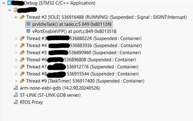

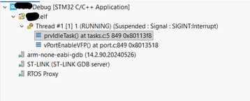

2026-03-03 1:52 PM
Hi
The symptoms were that the tasks were listed so that the call stack could be investigated
This is what i expect
This is what i got
Best regards
Martin
