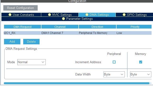

if(hi2c->State == HAL_I2C_STATE_READY) never pass
Maybe there is something special in DMA configuration that I need to do?
