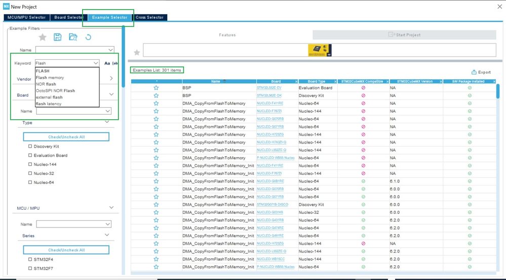

Here's one

Hello @VAvag.1 ,
Let me first welcome you the STM32 Community :smiling_face_with_smiling_eyes:
STM32CubeMX tool comes with the Example selector feature allowing you to browse a large set of examples and to start a new project from a selected example for some STM32 MCUs/MPUs.
Each example comes a readme.txt file describing its behavior and the environment required to run the example.
You can refer to STM32CubeMX User manual for further details about tool features.
Hope this answers your question. If it is the case, please click on the Select as Best button on my reply . This will help other members of the community find this solution more quickly.
Otherwise feel free to raise any feedback.
Khouloud.
