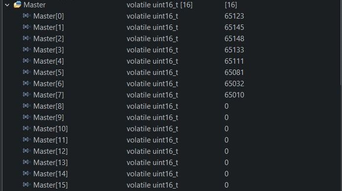

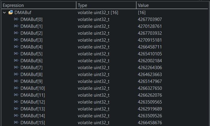

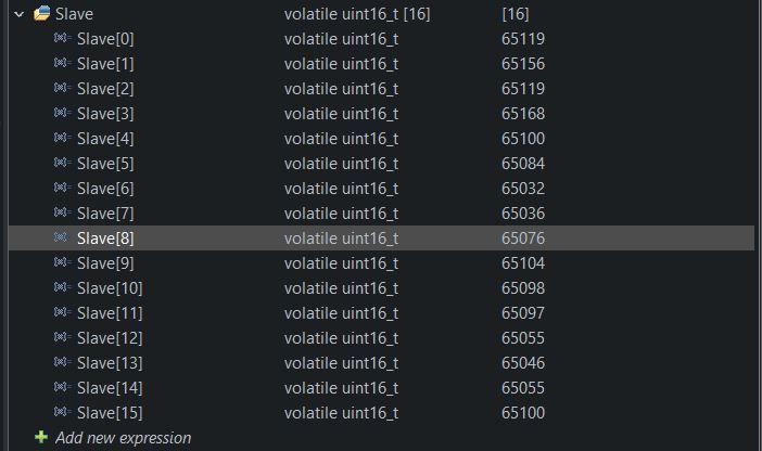

First time try ADC Dual Interleaved on STM32H750VB.
The problem is when I try to split the 32bit result from DMABuff into 16bit master and slave, some of the reading is zero and it's random. Can anyone show me anything wrong on my code?
If disable DCache and allocate DMABuff on RAM_D1.
Without calling the SCB_InvalidateDCache_by_Addr, then there is no issue.
Below is my code:
__IO uint32_t DMABuf[BuffSize];
__IO uint16_t Master[BuffSize];
__IO uint16_t Slave[BuffSize];

2021-08-12 2:03 AM
Your DMA buffersize is 64Byte (4x16). Therefore you have to invalidate half buffersize of 32Bytes (2*BuffSize).
And take care to align the DMABuf to 32 Byte boundary because this is the data cache size. Otherwise you invalidate also parts of unwritten cached memory before or behind DMABuf, e.g. Master or Slave (depending on your memory layout).
2021-08-12 2:03 AM
2021-08-12 2:12 AM
Firstly, DMABuf's size is BuffSize * sizeof(uint32_t) bytes. So your length parameter to SCB_InvalidateDCache_by_Addr is incorrect.
Secondlythe M7 cache lines are 32-bytes and if DMABuf isn't cache-line aligned or BuffSize * sizeof(uint32_t) is not divisible by 32, your SCB_InvalidateDCache_by_Addr is also invalidating variables below and and above DMABuf in memory.
Check DMABuf in your link map file to confirm.
The __IO (volatile) on your DMABuf is unnecessary.
2021-08-12 2:25 AM
Thanks all, Now I know where is the problem.
