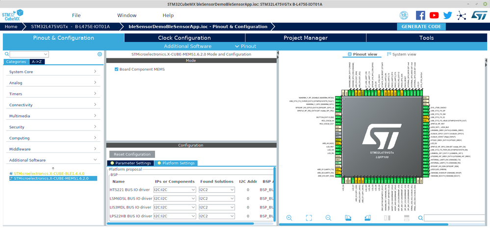

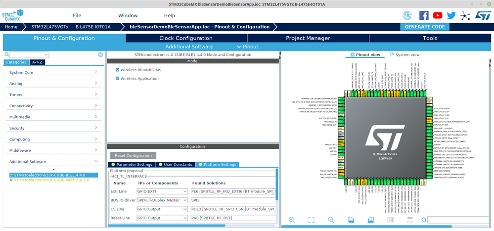

My solution is to generate the project with just BLE. Use file manager to copy the BlueNRG-MS directory to somewhere else. When selecting any MEMs modules and regenerating the code it will empty the BlueNRG-MS directory. Copy the contents of the saved one back and good to go.
