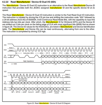

Simplified the program to just read the Manufacturer ID instead of write/read using 0x92 command
Code to Read the ID

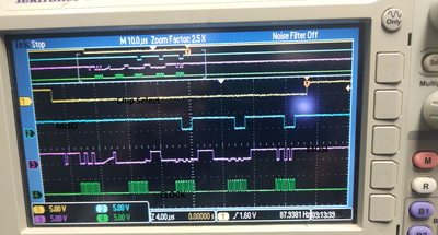

Here is what I see on the Scope.
Please let me know if there is anything, I am missing.
2023-09-15 3:33 PM

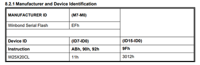

Use the HAL_SPI_TransmitReceive(), Identify traces, don't be using DUAL mode for single bit SPI, would explain the wrong levels on the Purple trace as both ST and WINBOND are trying to drive the same pin.
Use the 0x9F command (JEDEC ID). send 0x9F, then recover responses to sending 3 zeros.
Bus is symmetrical, the write clocks, data goes out on one edge, read back on the other.

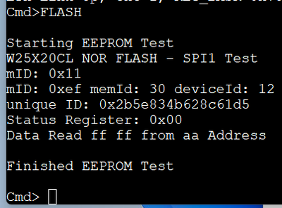

Thanks! I tried
Still having issue reading back Status Register and Write/Read command, really appreciate the response, here is the code I am using

I would make sure the SPI register has been sent before raising SPI1_CS
I would raise SPI1_CS after sending WREN command is sent. With some delay between it going high before going low again.
Print the two SR1 / SR2 values with separation or %02X %02X forms. When writing check for completion. WREN bit should reflect in SR1.WEL
