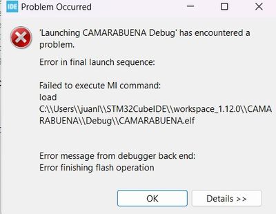

When I try to connect under reset by grounding the NRST pin, the following message appears:
