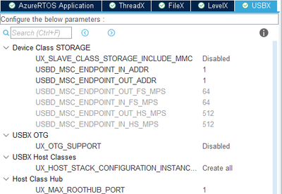

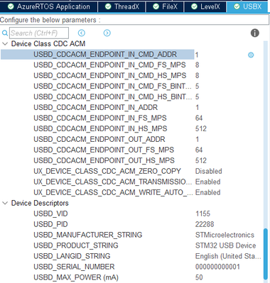

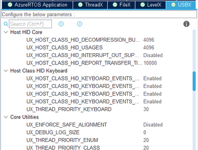

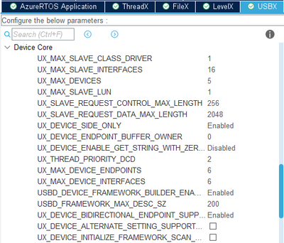

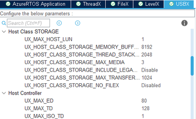

In the USBX configuration, everything seems to be setup properly as well.
Everything seems to be configured properly.... so now lets get CubeMX to generate the code....

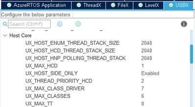

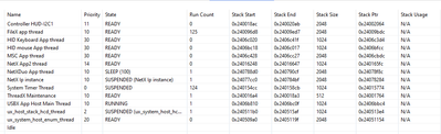

from there it calls MX_USBX_Host_Init() and MX_USBX_Device_Init() which in theory initializes all the pointers, memory, stacks, threads, etc. This all sounds good, and compiles without issue. When debugging you see all the tasks, Mutex, Queues, etc, but the system randomly get hardware faults, memory errors, etc.
The problem is that CubeMX did not generate the #defines properly for the AZRTOS code. IMPORTANT note; negative logic is being used to initialize the pointers and stack. For example in file: _ux_system_initializatize.c, you can see negative logic being used (defines) to initialize the main USBX structure. (and it appears to be done this way through out the USBX code).

_ux_system_host and _ux_system_device are the primary structures in USBX code. Neither of them get initialized properly and at run time are both set to address 0x00000 (which points to ITCMRAM).
So how can this code with negative logic ever run? @FBL
This is a bug on the CUBEMX side - by not defining the proper system defines, and on the Embedded Code side because of all the negative logic (#defines) when trying to initialize the code.
