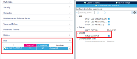

I installed the latest CubeIDE hosted on a Mac to demo a NUCLEO-H755 board over USB. Starting from a clean CubeMX code generation, I've managed to successfully create a basic application to blink the user LEDs and use the pushbutton (along with basic use of the debugger), but I would like to be able to configure the Virtual COM Port (VCP) to use as a debugging tool before proceeding to the next step of getting the Ethernet working. Unfortunately, I have not been able to figure out how to get the VCP to work. In CubeMX, I have USART3 selected as the VCP with the correct pins per the schematic, but for some reason the only available selection is "disabled". I suspect this might be because the NUCLEO board support package (bsp) is somehow controlling configuration of the VCP and not allowing changes from CubeMX. Here are my questions:

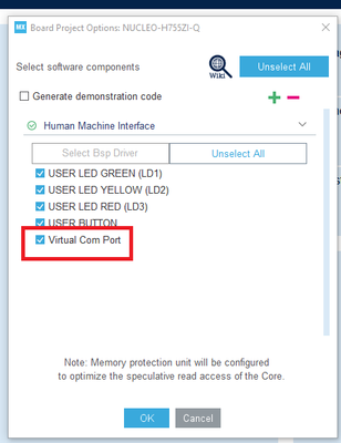

2025-01-02 1:01 AM
@paatx wrote:
1) Does the NUCLEO bsp automatically configure the VCP, or is there some other way to configure?
If at the beginning of the project generation you kept that option selected.. Yes:
If you want to do it yourself, you can go to Bsp section and disable Virtual comport by unchecking "Virtual Com Port" option. USART3 will be enabled gain in Connectivity.

2025-01-02 9:14 AM
So if I let the BSP configure the Virtual COM Port, shouldn't I just be able to open a new serial console in CubeIDE to see my printfs? I've tried this and none of my printf outputs show up even though the console says it is connected...
2025-01-02 9:34 AM
I finally got this to work using the default BSP VCP configuration, and a terminal window within CubeIDE. The trick was to create a "New Command Shell Console" within CubeIDE using USB as the connection type. This wasn't initially obvious since the only instructions I found online don't seem to completely match the new version of CubeIDE.. Thanks for the help.
