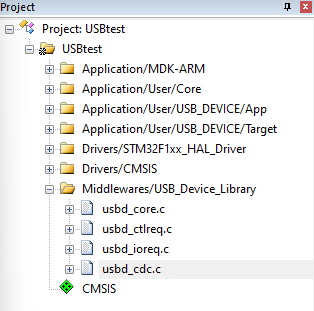

It's my 2nd day using STM32, i don't know what to do and here's the screenshoot

Hello @choirulafiq29 ,
Further to your comment, I reproduced your behavior, and I did not get the compilation errors which you had encountered.
usbd_core.c ; usbd_req.c ; usbd_ioreq.c ; usbd_cdc.c are well generated.
I want to know please the F1 Firmware version.
I will be waiting for your feedback/
Thanks.
Mahmoud

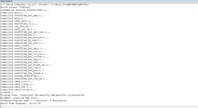

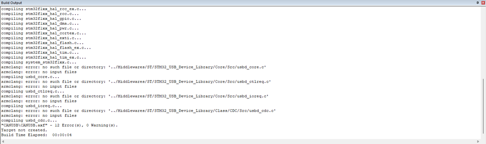

2025-07-02 2:56 AM
Thanks for your responses, here's the screenshoot of my compiling message error
