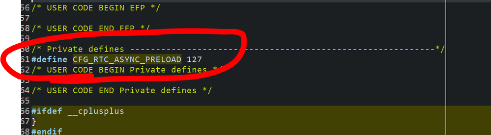

Can someone tell me how to use constants that are #defined in main back in the .ioc file? I have run the CubeMX and generated the ioc file then generated main. I then do work in main and make some changes to the initialization features that CubeMx generated. Now I am finding (for other reasons) to go back into CubeMx but each time I regenerate I overwrite the #defines with values. Is there a way to just fill in the integer values with constant names in the ioc file ??? Is there a way to do variables from main backwards to the ioc file (guessing not here but wanted to ask)???

You can't go from code to IOC file, only from IOC to code.
If you put your definitions within USER CODE sections, they will not be overwritten, barring CubeMX bugs. Any modifications outside of these sections are overwritten.

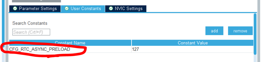

2021-12-06 10:18 AM
You can define a user constant and use that for the value instead of a numeric value. Maybe that's what you're looking for?
But if you change the numeric value in the code, the IOC isn't updated and it'll be overwritten when you regenerate. You could change the value in the IOC and regenerate to update it.

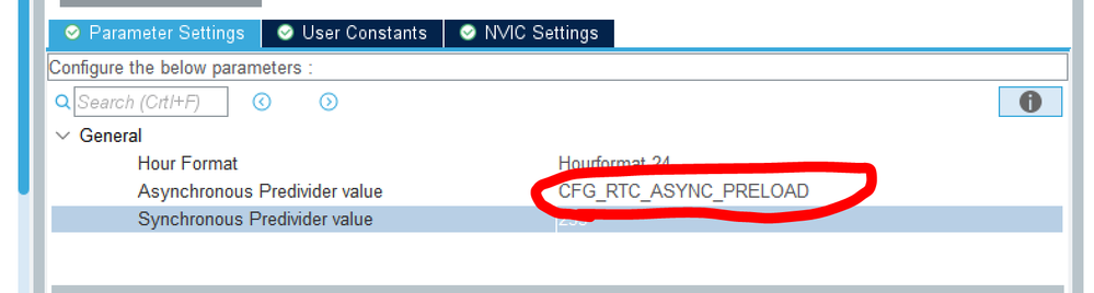

2021-12-06 10:31 AM
Some CubeMX config fields have "validation" options. If you click on a field, say the "Asynchronous Predivider Value" line under RTC, look for a little plus sign in a circle at the right hand edge of that line. Click on that "+" and select "No Check". You can then enter any value you want, including any define that you have elsewhere in the code. I use this is set the I2C slave addresses. For example, I'll have in my code:
#define FLAMMERJAMMER_I2C_ADDRESS 0x5cthen in CubeMX, I will set the "Primary Slave Address" field to "FLAMMERJAMMER_I2C_ADDRESS" instead of a hard-coded decimal or hex value.
2021-12-06 10:36 AM
While you CAN define that value in CubeMX, you don't have to. I usually don't use the "User Contrants" tabs as I like the ability to change the defines w/o needing to re-run the CubeMX/code generation step just to tweak some value. And having the define outside CubeMX's control also allows me to document/comment WHY that define has that particular value (for times when it isn't totally obvious).
