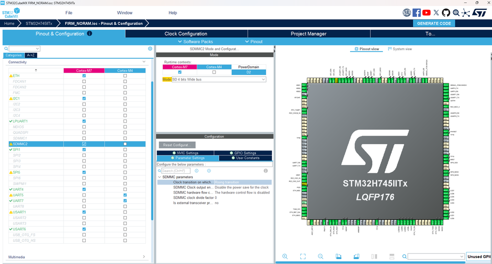

I'm trying develop code with STM32H745IIT using SDMMC2 in M7 core based in this tutorial:
https://www.youtube.com/watch?v=I9KDN1o6924
My version the CubeMX is: 6.17 and STM32CubeIDE is 2.1.0
Initially I set mode: SD 4 bits Wide bus and configuration is:
NVIC: Enabled
NO constants
GPIO Setting:
- PB3: D2, PB4: D3, PB14: D0, PB15: D1, PD6: CK and PD7: CMD

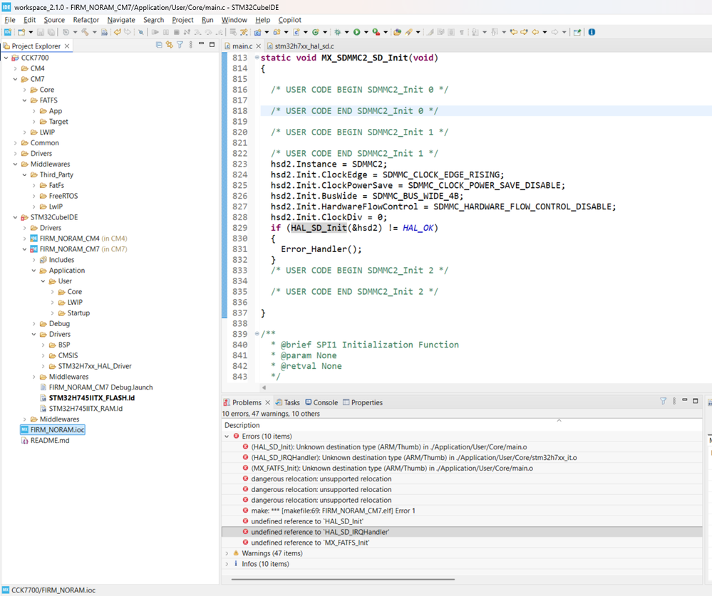

Only with this code is the following error generated in CubeIDE:
(HAL_SD_Init): Unknown destination type (ARM/Thumb) in ./Application/User/Core/main.o
(HAL_SD_IRQHandler): Unknown destination type (ARM/Thumb) in ./Application/User/Core/
undefined reference to `HAL_SD_Init'
undefined reference to `HAL_SD_IRQHandler'

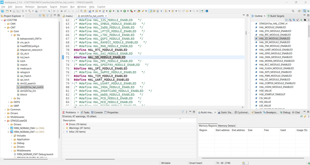

Is the macro #define HAL_SD_MODULE_ENABLED is defined in stm32h7xx_hal_conf.h. If this define is missing, the SD HAL APIs such as HAL_SD_Init() and HAL_SD_IRQHandler() may not be compiled correctly.
2026-05-06 2:26 AM

2026-05-06 4:45 AM
Hello @Saket_Om
Thank for your help! Yes the macro #define HAL_SD_MODULE_ENABLED was defined in stm32h7xx_hal_conf.h
What I find strange is the location of these files:
stm32h7xx_hal_conf.h is in:
..\workspace_2.1.0\CCK7700\CM7\Core\Inc\stm32h7xx_hal_conf.h
and the M7 main file is in:
..\workspace_2.1.0\CCK7700\CM7\Core\Src\main.c
see project explorer in left

Yes, have many erros:
Description Resource Path Location Type
(HAL_SD_Init): Unknown destination type (ARM/Thumb) in ./Application/User/Core/main.o FIRM_NORAM_CM7 C/C++ Problem
(HAL_SD_IRQHandler): Unknown destination type (ARM/Thumb) in ./Application/User/Core/stm32h7xx_it.o FIRM_NORAM_CM7 C/C++ Problem
(MX_FATFS_Init): Unknown destination type (ARM/Thumb) in ./Application/User/Core/main.o FIRM_NORAM_CM7 C/C++ Problem
dangerous relocation: unsupported relocation FIRM_NORAM_CM7 line 0, external location: C:\Users\jeand\STM32CubeIDE\workspace_2.1.0\CCK7700\CM7\Core\Src\main.c:263 C/C++ Problem
dangerous relocation: unsupported relocation FIRM_NORAM_CM7 line 0, external location: C:\Users\jeand\STM32CubeIDE\workspace_2.1.0\CCK7700\CM7\Core\Src\main.c:829 C/C++ Problem
dangerous relocation: unsupported relocation FIRM_NORAM_CM7 line 0, external location: C:\Users\jeand\STM32CubeIDE\workspace_2.1.0\CCK7700\CM7\Core\Src\stm32h7xx_it.c:215 C/C++ Problem
make: *** [makefile:69: FIRM_NORAM_CM7.elf] Error 1 FIRM_NORAM_CM7 C/C++ Problem
undefined reference to `HAL_SD_Init' FIRM_NORAM_CM7 line 0, external location: C:\Users\jeand\STM32CubeIDE\workspace_2.1.0\CCK7700\CM7\Core\Src\main.c:829 C/C++ Problem
undefined reference to `HAL_SD_IRQHandler' FIRM_NORAM_CM7 line 0, external location: C:\Users\jeand\STM32CubeIDE\workspace_2.1.0\CCK7700\CM7\Core\Src\stm32h7xx_it.c:215 C/C++ Problem
undefined reference to `MX_FATFS_Init' FIRM_NORAM_CM7 line 0, external location: C:\Users\jeand\STM32CubeIDE\workspace_2.1.0\CCK7700\CM7\Core\Src\main.c:263 C/C++ Problem
2026-05-06 7:59 AM - edited 2026-05-06 8:20 AM
So you do have "dangerous relocation" errors:
The reason for those, and how to fix them, is in the thread I linked earlier.
TL;DR: you need to downgrade your GCC toolchain to an earlier version.
