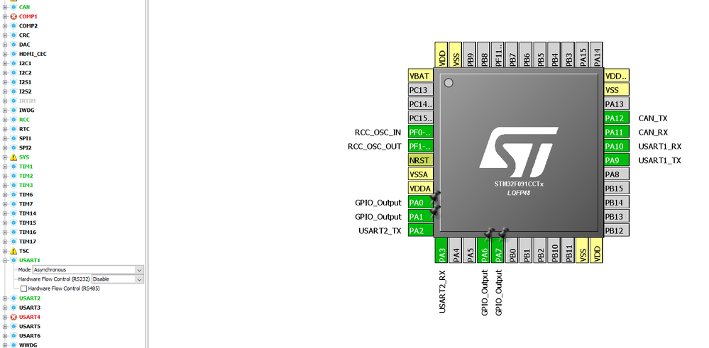

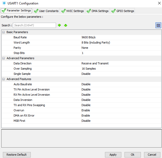

i want to reach my flash memory through UART. I can do this with ST-Link device but now i want to do it with UART. I use STM32F091CC MCU and as datasheet says i configured the UART pins(PA9-PA10) as Asynchronus UART in CubeMX.
My baud rate is 9600 bits/s- word legth 8bits - parity - even and stop bit is 1.
In boot mode configuration. I try to use all configurations but i cannot reach the flash memory.

Pinout:

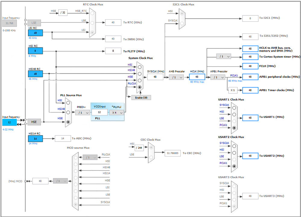

Clock Conf:
uart confs:

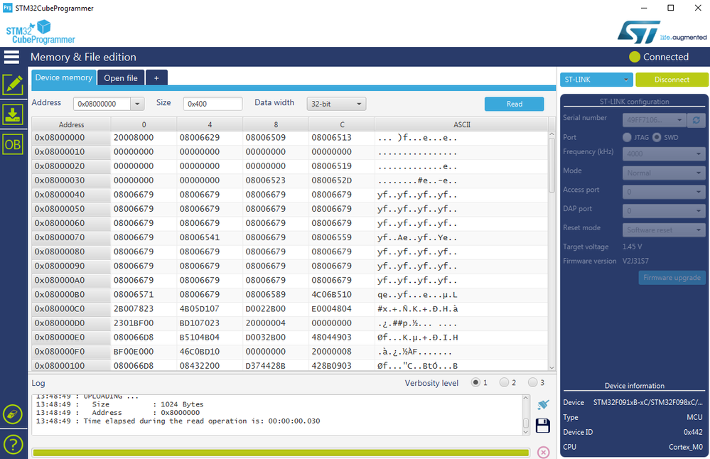

I tried to use STM32F091 with UART connection and STM32CubeProgrammer. I used UART pins PA2 and PA3. I used Nucleo board with integrated USB to UART virtual COM port (VCP). Connection is correct - no problem. See attached screenshots: see there given UART configuration, option bytes configuration (I just set externally BOOT0 pin to VDD), device memory is empty (no code inside). Please check this configuration in your side.
