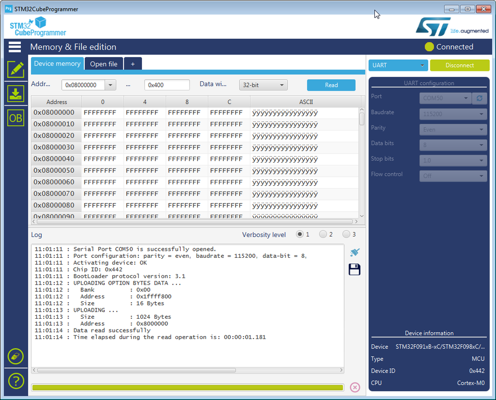

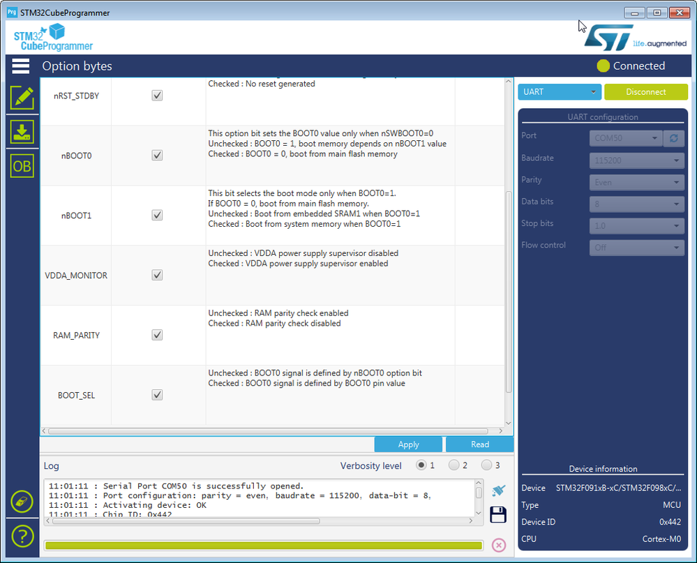

2018-11-08 2:34 AM
I tried to use STM32F091 with UART connection and STM32CubeProgrammer. I used UART pins PA2 and PA3. I used Nucleo board with integrated USB to UART virtual COM port (VCP). Connection is correct - no problem. See attached screenshots: see there given UART configuration, option bytes configuration (I just set externally BOOT0 pin to VDD), device memory is empty (no code inside). Please check this configuration in your side.
