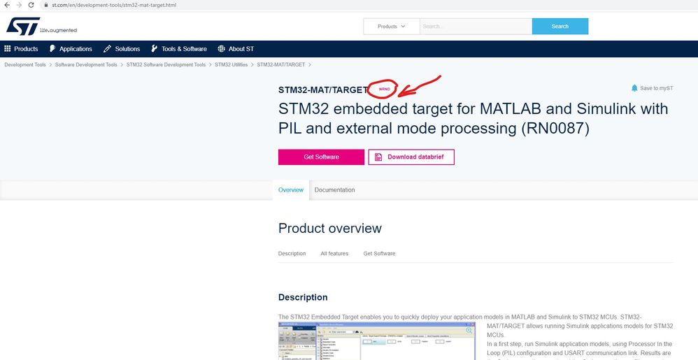

@HTeno.1 my pain is such STM32-MAT utility is marked as NRND (i.e. Non Recommended for New Design) ... are such IDE & MX recent releases still compliant with ? but if lucky already @mattias norlander is promoting good tips.

2021-05-21 10:21 AM
Yeah, I realized this after talking to their support a couple weeks ago.
