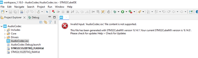

I have Version STM32CubeIDE : 1.18.0, and I get a program that was communicated to me, but I have this message below :

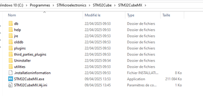

And I downloaded and installed STM32CubeMX 6.14.1 version, but it seems that it is not taken into account in the environment of STM32CubeIDE version 1.18.0.
Here is the path I installed the STM32CubeMX 6.14.1 version

Hello @DYann.1
The version of the STM32CubeMX integrated on the STM32CubeIDE is an independent plug-in and does not depend on the version you have installed as standalone. So, to have an STM32CubeIDe with the STM32CubeMX V6.14.1 integrated, you have to download and update to the STM32CubeIDE V1.18.1.
Best Regards.

2025-04-22 5:22 AM
Hello STTwo-32,
Thank you I'll install the new version of STM32CubeIDE.
2025-04-22 5:28 AM
If this solves your issue. Please mark the comment of the answer as best answer to close the thread.
Best Regards.
STTwo-32
2025-04-22 5:50 AM
Of course, I just finished the installation and it works. Thank you.
