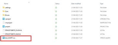

2025-04-22 12:46 AM - edited 2025-04-22 2:44 AM
Hello @chris239955_stm1_stmicro_com
Go to your project folder and upload the file with the extension .ioc as shown in the screenshot.(example)
