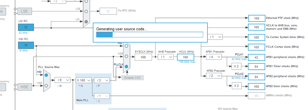

2019-01-19 8:20 AM
Here the clock tree

2019-01-19 12:46 PM
What STM32 and which package is being used here? Which GPIO for USART are selected?
2019-01-19 2:02 PM
its STM32F407 Disco, using UART4:
PA0-WKUP ------> UART4_TX
PA1 ------> UART4_RX
2019-01-19 8:36 PM
Sanity check: If in main you use HAL_Delay() which uses systick, does it work?
This in case Systick is not properly working and all timeouts and delay functions are KO
