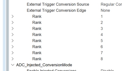

With new and fast N6 MCU comes new CubeMX package which is full of bugs and errors, I spending hours to find and solve such problems, now I cant trust cubeMX at all, every function must be checked after code generation !

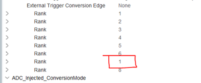

ADC rank must be 7, but cubeIDE generate 1:

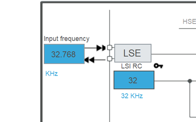

I trying to enable LSE, but because of some error with frequency settings which I cant set, I cant enable !
